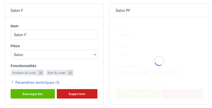

I’m reorganizing all my devices a bit following the new features allowed with external integrations.
I’m in the Overkiz integration and assigning rooms to my devices.
The issue is that the first ones I click save quickly and the following ones have the thing that spins for looooooooong :frowning:
For info, it’s been 5 minutes and nothing is happening visually and if I go to another page, Gladys no longer responds.
I noticed this on other integrations but not as long and therefore I don’t know if it’s Overkiz or Gladys that has the problem.
EDIT: well still nothing, only solution: restart the docker :frowning:

I noticed there’s the same issue when deleting a device, but I don’t know if it’s related :wink:
