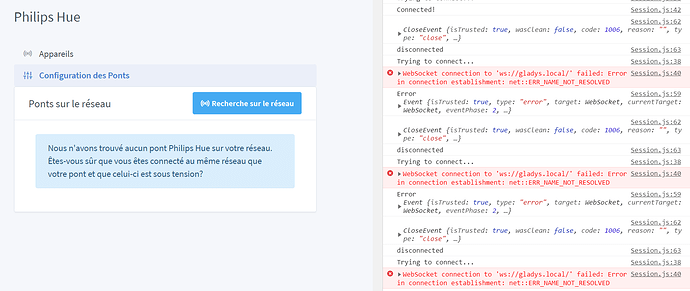

I don’t see « Starting philips-hue service » in your logs, that’s not normal, I think you must have stopped the service manually?
That’s not normal, I suppose you are connected via http://gladys.local? It’s strange that it can’t perform the local DNS resolution during the websocket connection while it can do it in your browser via HTTP…
Can you try with the IP and show us the same logs?
You still have an unusual internet box (4G box), and I wouldn’t be surprised if this type of box is configured differently from traditional routers in terms of network!

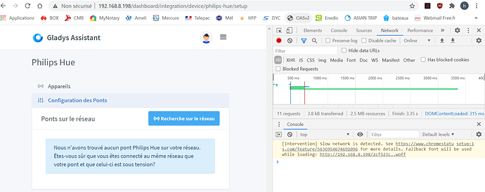

Good evening everyone,
I connected with the IP address and stop/start the Philips service…

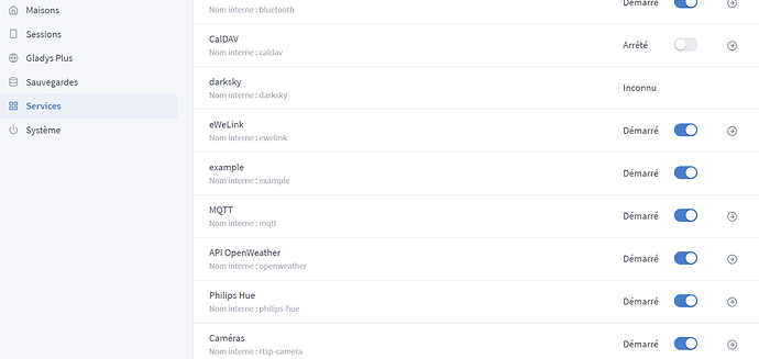

To see the status of the services it’s via the interface
To format your posts you can use this topic => [TUTORIEL] Formater son code dans un message: Aidez nous à vous aider ;)
Yes, exactly, I use this interface to check, start, or stop services.
By the way, the Bluetooth service seems to be malfunctioning as well, both on the interface and in the logs… but perhaps that’s normal since I haven’t configured anything on the Raspberry Pi side.

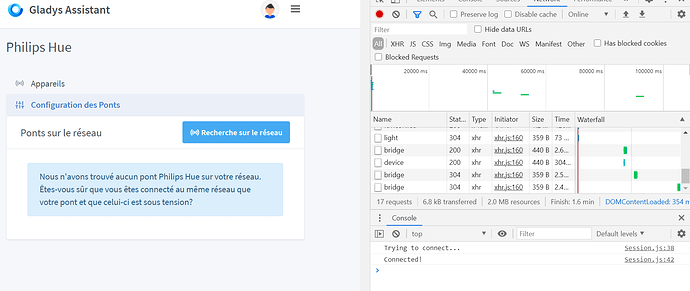

Have you tried, like I did earlier, waiting 30 minutes / 1 hour while refreshing regularly? Even if it’s not normal, it can be an indicator if we both reproduce the same thing.
Have you done an « inspect » on the web page again? And do you still have the same errors? Can you also go to the « network » tab of this « inspect » window and take a screenshot of the different returns (for this, open the network tab and then refresh the Philips-hue config page, things should appear below)

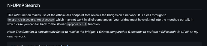

@Herve I went into more detail about the integration, and I just remembered that to find the bridges on the network, we do an N-UPnP Search which is based on the Philips Hue API:
Therefore, your bridge must be registered with Philips Hue, is that the case?
Perhaps we should add this to the documentation.
@pierre-gilles, yes my bridge is registered on the Philips Hue side and works.
However, how should I use the N-UPnP Search command?
You don’t need to do anything, I was talking about the code in Gladys. It’s Gladys that performs the N-UPnP search :slight_smile:

The API suggests falling back to upnpSearch if the first method doesn’t work. Is there a reason not to do that, or should we try it?
@VonOx it doesn’t work with ! :blush:
I see two possible fixes:
  • First, update the lib to the latest version (4.0.9), whereas on our side we are using 3.4.0. There may be changes in the Philips Hue API that would cause some bridges not to be returned
  • Then, add a case, if the result of the nUpnp search is an empty array, launch an Upnp search
@VonOx could you make a PR? or should I take care of it? :blush:
Edit: done, PR here: Upgrade philips-hue dependency to 4.0.9 & improve bridge search by Pierre-Gilles · Pull Request #1080 · GladysAssistant/Gladys · GitHub
