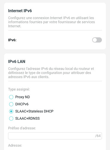

Here’s what I have:
If I enable Internet IPv6, nothing changes. I imagine it’s the parameter above that needs to be modified (IPv6 LAN)?

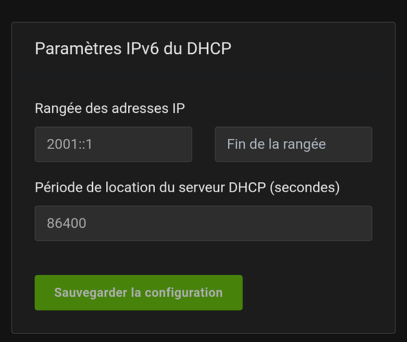

I have this but I can’t change the settings. I’ll investigate further…
