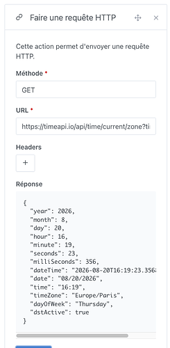

Cool if we no longer have to make an HTTP GET request to retrieve the date and time
But does this take into account the host Gladysâs time?
Because I think I have a difference when I look at the logs and the corresponding times, 1 or 2 hours
It seems to take the host Gladysâs time
The times in the logs of external integrations are in UTC
I checked that the Gladys Docker logs are indeed in the correct timezone
I will create a feature request for the timezone of external integrations
