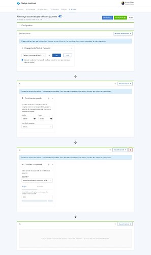

I am in the same situation as @Fabic and @lmilcent because I want to combine conditions (movement in a room AND low brightness = turn on a light for 30 seconds, low brightness AND NOT (from 11:30 PM to 8:00 AM) = turn on a light).
Would it be possible to write a detailed example for us with screenshots? Once this document is made available, I think many (myself first …) will understand how to implement everything else :slight_smile:
Thank you,
Have a nice day,
Jean
Hi @jean_bruder :slight_smile:
All of that is entirely possible and relatively simple!
I’ll show you two examples from my personal setup:
Toilet lighting (daytime)
At my place, the toilet lights turn on at full power between 8:00 and 20:00 (and more dimly at other times)
Here’s the scenario that turns the toilet lights on during the day:

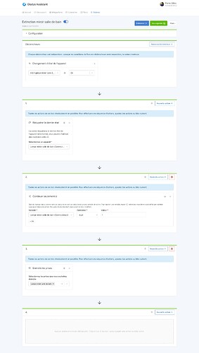

Bathroom mirror lighting
For my bathroom mirror, I installed a push button — when the light is off it turns it on, when the light is on it turns it off)
Here’s how I did that:
