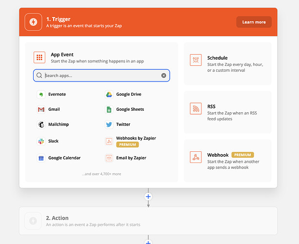

Zapier side:
IFTTT side:
Do you understand the operation better with the Zapier UI? They clearly state that a trigger is an event.
