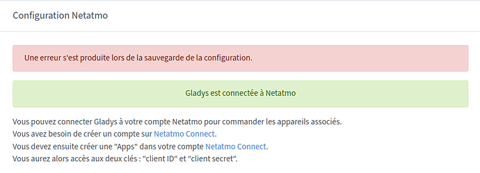

For my part when I tried Sauvegarder la configuration \u0026 Connecter I got this error
2023-12-07T23:31:48+0100 <error> netatmo.saveConfiguration.js:27 (NetatmoHandler.saveConfiguration) Netatmo configuration stored errored ValidationError [SequelizeValidationError]: notNull Violation: t_variable.value cannot be null
    at InstanceValidator._validate (/src/server/node_modules/sequelize/src/instance-validator.js:78:13)
    at InstanceValidator._validateAndRunHooks (/src/server/node_modules/sequelize/src/instance-validator.js:111:7)
    at InstanceValidator.validate (/src/server/node_modules/sequelize/src/instance-validator.js:93:12)
    at model.save (/src/server/node_modules/sequelize/src/model.js:3996:7)
    at Function.create (/src/server/node_modules/sequelize/src/model.js:2280:12)
    at Variable.setValue (/src/server/lib/variable/variable.setValue.js:27:32)
    at NetatmoHandler.saveConfiguration (/src/server/services/netatmo/lib/netatmo.saveConfiguration.js:19:5)
    at saveConfiguration (/src/server/services/netatmo/api/netatmo.controller.js:30:20) {
  errors: [
    ValidationErrorItem {
      message: 't_variable.value cannot be null',
      type: 'notNull Violation',
      path: 'value',
      value: null,
      origin: 'CORE',
      instance: [t_variable],
      validatorKey: 'is_null',
      validatorName: null,
      validatorArgs: []
I tried a second time and then the NetAtmo page opened to validate the connection.
However the error banner remained

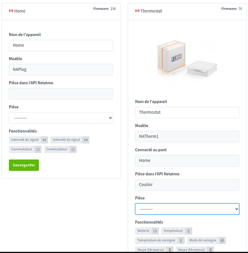

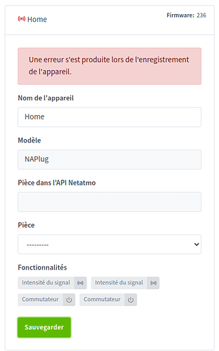

I got an error when I tried to Save and couldn’t save NAPlug.
No problem with the thermostat.
In the logs I have these 2 errors and I can’t change the temperature setpoint.

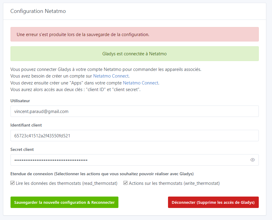

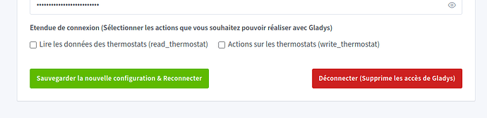

After this error indicating permission issues I checked the config and the 2 boxes were unchecked even though I had checked them.
I then rechecked them, revalidated the rights in NetAtmo but if I change page or refresh the page the 2 boxes are unchecked again.

Indeed the first is mandatory, it would make no sense not to check it. I had enabled everything mainly to leave the choice for writing, but Pierre-Gilles is probably right, we make choices and we own them. So I’ll remove the options and indicate in the heading above that we necessarily grant read and write rights on the Thermostat because that’s the basis of the integration. We’ll see about other additions in future PRs.
Mandatory for full control.
Indeed ^^
Ah I hadn’t tested the identifier error, only the « Decline » ^^

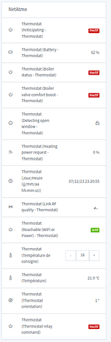

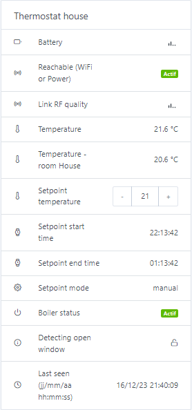

On my side, I see 2 issues in the dashboard rendering, but they should be present in other usages of these categories:
  • Setpoint temperature with 150% zoom OK :
    But zoom < 150% NOK, the « , » are missing:
  • And for the « open window » category I correctly receive false from Netatmo (logical, no window open) and the icon is an open padlock:
    That doesn’t make sense to me, I know there’s often been debate about these binaries… but aside from finding an open/closed window icon…
    I’m willing to change the received value to « 1 » rather than « 0 » but it still seems illogical, no?
For the rest I put binary switches for all binaries, but would it make sense to add categories if they’re not handled differently? Just for the icon…

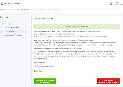

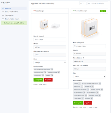

Updates :
  • Devices Page - added devices’ connection status (green or red icon at the top left of the card), added the plug to which the thermostat is connected (in my case I have 2 and this will make even more sense when the valves are added), and finally added the room where the devices are located in the Netatmo API:
  • Discovery Page - added a blurb for compatible equipment plus a link to the forum page « Feature Request »:
  • Configuration Page - Removed the email address which isn’t useful after all, added a blurb about the scopes which give full rights to Gladys to access data in read and write, added information on how the Energy API works concerning temperature / setpoint temperature.

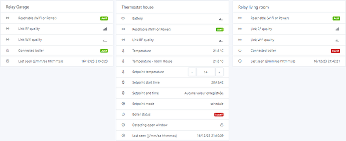

  • Dashboard Page - The dashboard when the boiler is not running:
The dashboard when the boiler is running:
You can see that I added the room temperature in addition to the Thermostat temperature because Netatmo acts on the room temperature. Having another Netatmo temperature sensor at the other end of the room (linked to the weather station), you can see that between the setpoint and the temperature (21 vs 21.6) the boiler would not have started.
How could I add this information more clearly in your opinion? Does it belong in the « Configuration » menu?

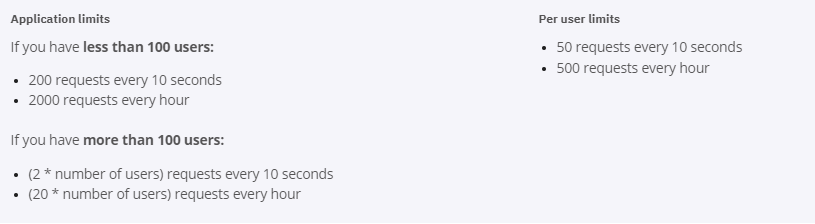

One question: I set a poll interval to 2 minutes (because at the time that was the refresh rate I observed on the Netatmo side, and it still seems to be the case).
Do you think I should mention that somewhere?
Should I reduce it to 1 minute just in case? Knowing that the limits are:
And knowing that for Gladys Plus users there will also be webhooks (not everything is supported on the Netatmo side but a wide range nonetheless)

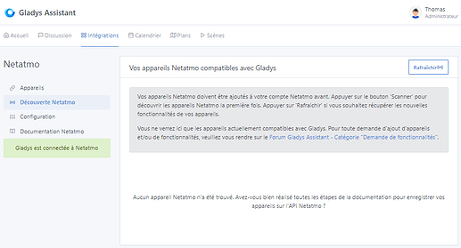

Hello @Terdious, I just tested this new image.
The feature configuration will, in my opinion, need more explanation in the documentation section (I assume that’s already planned — it’s good to mention it). Indeed, for selecting the scope, I don’t think it’s within everyone’s reach; on my side, I selected read_station for my weather station (nothing more).
The connection went well — nothing to report on that front.

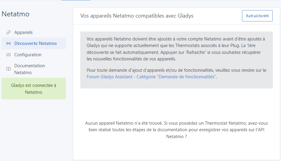

You specify in the integration:
You will only see devices currently compatible with Gladys here.
It’s good to state that, but for someone like me who doesn’t have a thermostat, when I start the scan the following message appears:
No Netatmo device was found. Have you completed all the steps in the documentation to register your devices on the Netatmo API?
Would it be possible to indicate that there is a device, perhaps even specify which one, and note that it is not yet supported?

Hello @PhilippeMA and thank you very much for this test!
Yes, of course, the documentation will contain (contains ^^) this part as an image!!
I added in the spiel about the scopes « You don’t have anything to configure, these scopes are automatically integrated and will be exposed to you during the connection request (see documentation if needed). »:
For the moment, I don’t want to complicate the code by surfacing unsupported devices, but indeed, that could be one of the next PRs. In the meantime I have revised the message, is it clearer? :
