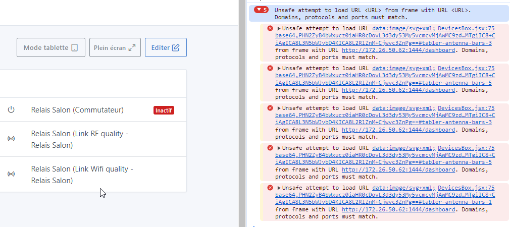

OK, so I’ll fix that too!! Still the problem on Chrome as well!! But not on Firefox and yet I’ve tested everything: zoom / unzoom / page enlargement / page reduction / mobile version!! It’s perfect on Firefox!!!
Worse, Chrome loses access to the signal quality icons!!
But the same on my Gladys prod since this afternoon!! :crazy_face: I searched for an hour before I noticed!!

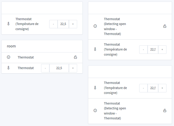

I just noticed something about the thermostat component regarding its width.
Below is a screenshot of one of my dashboards
If you look the thermostat in the living room doesn’t have the same width as the ones above.
Even though the name is identical.
I ran tests and the width also depends on the length of the name of the line just above
If I reduce the size of the temperature sensor name the thermostat’s width increases
And if I reduce it further I get the same width as the ones above
When I look again at the dashboard I created for Netatmo and see the size of the name on the line above the thermostat I now understand why the value is getting cut off.
So the bug comes from the thermostat. @pierre-gilles we have a bug — I’ll open a GitHub issue.
Well spotted!! What’s crazy is that I couldn’t reproduce it on Firefox even though the names are the same!! ^^

Here’s a recap of the different scenarios for the thermostat width problem
So the width depends on the thermostat name (makes sense) but also on the name of what comes before and after the thermostat.
