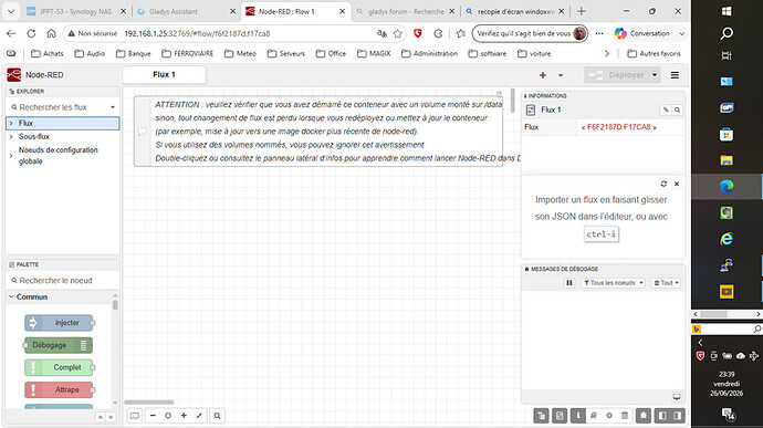

I noticed that the port 32769 was generated. Based on this, I copied the link of the node-red integration by changing the port in my browser. Result: I arrive at the node-red interface below.:star_struck:
Duplicating node-red via the container allows access to the .json metadata. Same principle for other containers.
However, disabling and then re-enabling in the integration interface results in a return to the previous situation, i.e., a node-red container that starts looping, so stop and delete.

However, the name is not Gladys-node-red and there is no flow storage or password request…
