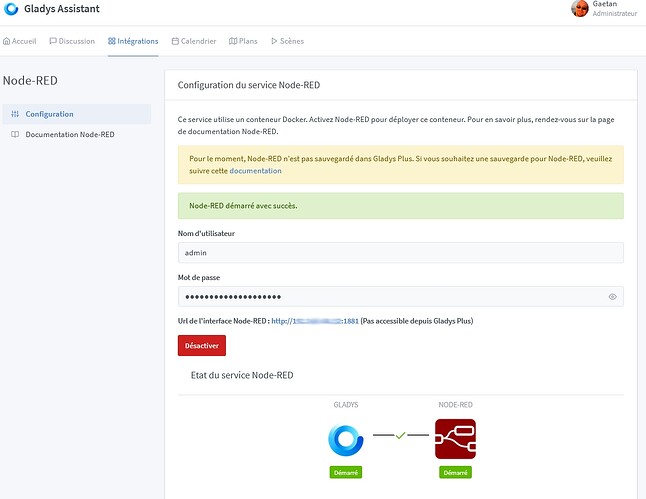

In the Node-RED configuration, is it possible to change the value shown in:
« Node-RED interface URL: http://xxx.xxx.xxx.xxx:1881 (Not accessible from Gladys Plus) »?
Because on my setup, the port is 1880.
Thank you in advance

The problem is that in the interface it says 1881 and when I click on it I end up on a page that asks for my username and password, and that page is not the right one, so I’m denied access every time I click the link.
The link should be redirected to my Node-RED port, which is 1880.
I’m having trouble understanding… can you take a screenshot of your interface using this link?
I wonder: didn’t you install your Node-RED on your side and also install the one provided in Gladys? That would mean that, in the end, you have two Node-RED containers running.

So the whole point is: what do you need? Because I admit I don’t understand it.
If you already had Node-RED installed, you can remove the one we see in your screenshot.
Or if for some reason you want to use that one, you can remove the old one — remember to back up your flows if you have any!
In any case, except for very specific cases (whose usefulness I have no idea about), having 2 instances of Node-RED is pointless :wink:
