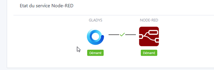

The service is not started in the list.
However, it indicates that it’s started:
Which one should I believe? ^^
I’d rather go with the screen on the Node-RED side; I don’t think the service status has anything to do with whether the Node-RED container is online or stopped :slight_smile:
