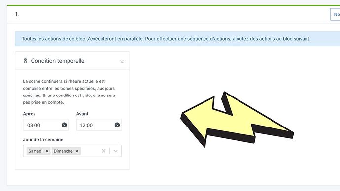

In fact, you are assuming that if your device is not detected even once at your place, it means you are no longer at home. However, in reality, Bluetooth disconnections of a few seconds happen all the time. That’s why historically on Gladys, people have rather made conditions based on a period of time without detection rather than on disconnection which causes false positives.
That’s correct. Initially, I wanted to do something else, but I think it’s still impossible to do with Gladys: to check the value of a sensor over a period of time (e.g.: no movement for 10 minutes).

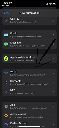

To appear on the local network, you can use the « Shortcuts » app on iOS (or Tasker or Automate on Android) to detect that your iPhone has just connected to (or left) your home Wi-Fi network.
Then, to send the information to Gladys, on iOS you can use Gladys Plus’s Open API, I made a tutorial last week:
On Android, for someone with time and skills, it is possible to send the data via MQTT if the MQTT broker is available on the internet :slight_smile:
