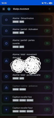

Today I go through the scenes and wall tablets.
For me, night mode is my partial alarm that triggers on door openings, not motion sensors.
My keyboard is the one from Gladys in tablet mode.
I have a 15/30 second timing after a door opens to disable my system. But everything is managed by Gladys on my side. I confirm, however, that it is a source of errors during setup. But I was testing as I went along.
I have scenes that call others, etc., but it gives an idea of what was done at the time.
