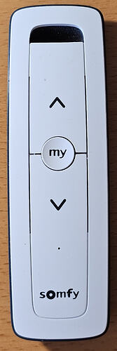

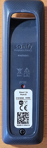

Somfy wireless remote control for awning
How can I make this remote control compatible with Gladys?
The answer is quite simple: buy a Connexoon or Tahoma Switch box, then integrate Overkiz.
Otherwise, it’s disassembly, soldering, ESP Home (well, I imagine).
