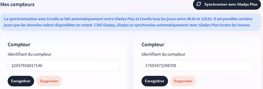

I still have one of the meters to integrate with ENEDIS, but I have an issue with them that is about to be resolved. So in what follows, there are only two.
Devices:
I have two undifferentiated ENEDIS meters:
1 Rename the meters
Actually, they have the PDL number and are not modifiable, which is not a big deal in itself.
2 Create a contract for each meter
Obvious, but since the name is not modifiable, I have three unidentifiable ENEDIS meters.

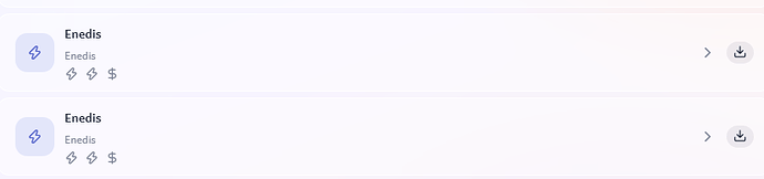

Integrations — energy tracking —-directly —contracts (no energy rates)
I am on 5.2.1… and energy tracking is native…
I think there was a step where you could link an MQTT meter created to ENEDIS…
Thinking to solve the problem, I created MQTT meters that I was able to rename, thinking to assign the correct contract, except that at the time of the preview:
tariff.components: must contain less than or equal to 16 items
result: I end up with MQTT meters not linked to ENEDIS

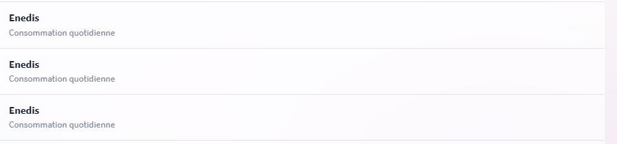

OK, I retrieved my third meter, but how do I distinguish the three Enedis:
How do I connect the MQTT meters?
