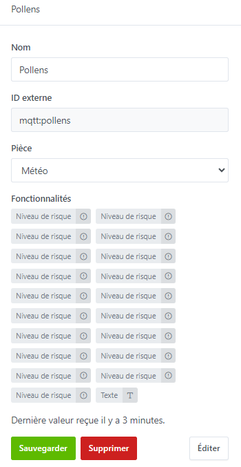

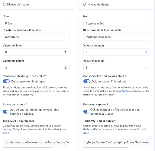

Tutorial - Retrieve info on pollen risk

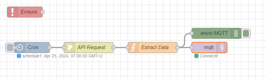

I will show you here how to retrieve pollen risk information and then transfer it to an MQTT topic.
The data comes from this website: https://www.pollens.fr

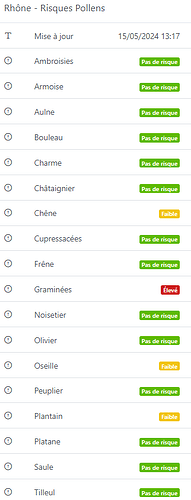

The final result:

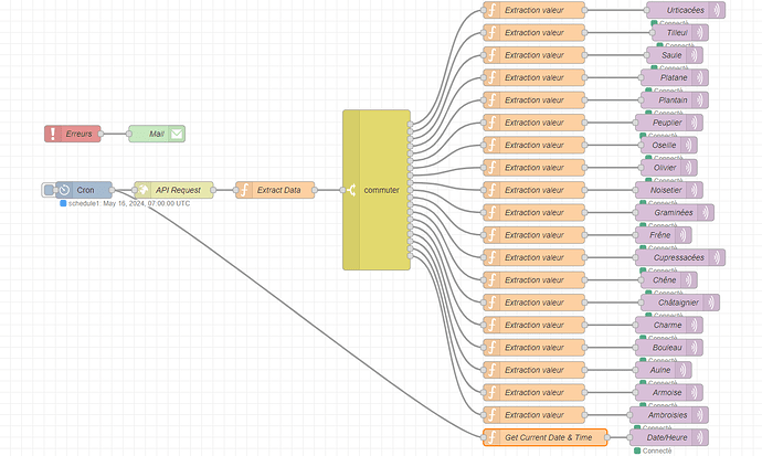

Here is the Node-Red flow:
(An error catch-all is present to retrieve errors and send them by email)
Here is the flow in JSON format to import into your Node-Red:
(The values are retrieved every morning at 9:00 a.m.)

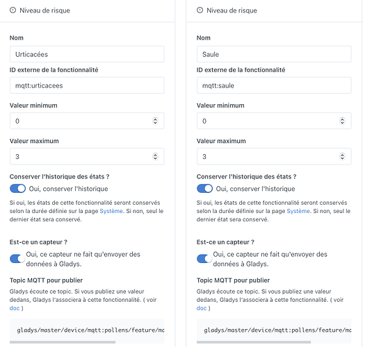

        "id": "7552d67540a2d961",
        "type": "mqtt out",
        "z": "bbc343252cb25eac",

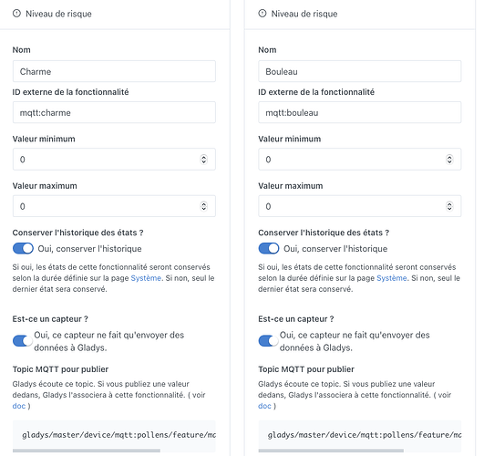

        "name": "Urticaceae",
        "topic": "gladys/master/device/mqtt:pollens/feature/mqtt:urticaceae/state",
        "qos": "",
        "retain": "",
        "respTopic": "",
        "contentType": "",
        "userProps": "",
        "correl": "",
        "expiry": "",
        "broker": "0ee77e0f90aa9681",
        "x": 1260,
        "y": 20,
        "wires": []

        "id": "a12343f669e4f8ce",
        "type": "mqtt out",
        "name": "Willow",
        "topic": "gladys/master/device/mqtt:pollens/feature/mqtt:willow/state",
        "qos": "",
        "retain": "",
        "respTopic": "",
        "contentType": "",
        "userProps": "",
        "correl": "",
        "expiry": "",
        "x": 1240,
        "y": 100,
        "wires": []

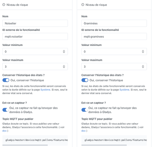

        "id": "e2fced2c1228b5b3",
        "type": "mqtt out",
        "name": "Hazel",
        "topic": "gladys/master/device/mqtt:pollens/feature/mqtt:hazel/state",
        "qos": "",
        "retain": "",
        "respTopic": "",
        "contentType": "",
        "userProps": "",
        "correl": "",
        "expiry": "",
        "x": 1230,
        "y": 340,
        "wires": []
        "id": "c9e8b061faf6b7ab",
        "type": "mqtt out",
        "name": "Grasses",
        "topic": "gladys/master/device/mqtt:pollens/feature/mqtt:grasses/state",
        "qos": "",
        "retain": "",
        "respTopic": "",
        "contentType": "",
        "userProps": "",
        "correl": "",
        "expiry": "",
        "x": 1240,
        "y": 380,
        "wires": []

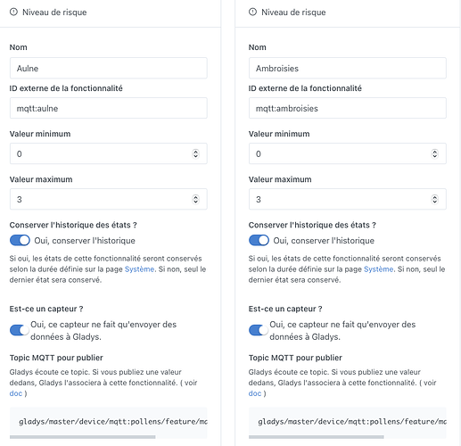

        "id": "68afc7734f581758",
        "type": "mqtt out",
        "name": "Ash",
        "topic": "gladys/master/device/mqtt:pollens/feature/mqtt:ash/state",
        "qos": "",
        "retain": "",
        "respTopic": "",
        "contentType": "",
        "userProps": "",
        "correl": "",
        "expiry": "",
        "x": 1220,
        "y": 420,
        "wires": []

        "id": "ebb744a52f2d0284",
        "type": "switch",
        "name": "",
        "property": "payload.topic",
        "propertyType": "msg",
        "rules": [
                "t": "cont",
                "v": "Urticaceae",
                "vt": "str"
                "t": "cont",
                "v": "Linden",
                "vt": "str"
                "t": "cont",
                "v": "Willow",
                "vt": "str"
                "t": "cont",
                "v": "Plane Tree",
                "vt": "str"
                "t": "cont",
                "v": "Plantain",
                "vt": "str"
                "t": "cont",
                "v": "Poplar",
                "vt": "str"
                "t": "cont",
                "v": "Sorrel",
                "vt": "str"
                "t": "cont",
                "v": "Olive",
                "vt": "str"
                "t": "cont",
                "v": "Hazel",
                "vt": "str"
                "t": "cont",
                "v": "Grasses",
                "vt": "str"
                "t": "cont",
                "v": "Ash",
                "vt": "str"
                "t": "cont",
                "v": "Cypress",
                "vt": "str"
                "t": "cont",
                "v": "Oak",
                "vt": "str"
                "t": "cont",
                "v": "Chestnut",
                "vt": "str"
                "t": "cont",
                "v": "Hornbeam",
                "vt": "str"
                "t": "cont",
                "v": "Birch",
                "vt": "str"
                "t": "cont",
                "v": "Alder",
                "vt": "str"
                "t": "cont",
                "v": "Wormwood",
                "vt": "str"
                "t": "cont",
                "v": "Ragweed",
                "vt": "str"
        "checkall": "true",
        "repair": false,
        "outputs": 19,
        "x": 710,
        "y": 340,
        "wires": [
                "8d0adde0aff95a13"
                "45b3b282ee5c7f5b"
                "141cd61cf70552dc"
                "0c8d638c799564f0"
                "a76f02d65b5b251b"
                "ab7ba6214628bc23"
                "4b764b9864485c4c"
                "96b42f8a867b2fc6"
                "2f2dad2bd71e80f9"
                "552335c84c6fe8df"
                "26e08c68dc2065bb"
                "60bdf90b83076df1"
                "caec8f89d4738303"
                "6be8143442f0a2eb"
                "e43acc2af6e9fe96"
                "5d402663ddcf3d59"
                "2c3f0316affb6ae7"
                "19c57cc67447e518"
                "e48d51016db99b89"
        "id": "141cd61cf70552dc",
        "type": "function",
        "name": "Extract value",
        "func": "const topic = msg.payload.topic;\nconst payload = msg.payload.payload;\nmsg.topic = topic;\nmsg.payload = payload;\nreturn msg;",
        "outputs": 1,
        "timeout": 0,
        "noerr": 0,
        "initialize": "",
        "finalize": "",
        "libs": [],
        "x": 990,
        "y": 100,
        "wires": [
                "a12343f669e4f8ce"
        "id": "45b3b282ee5c7f5b",
        "type": "function",

Remember to change your department number in the « Api Request » node
And also the IP address of your MQTT broker

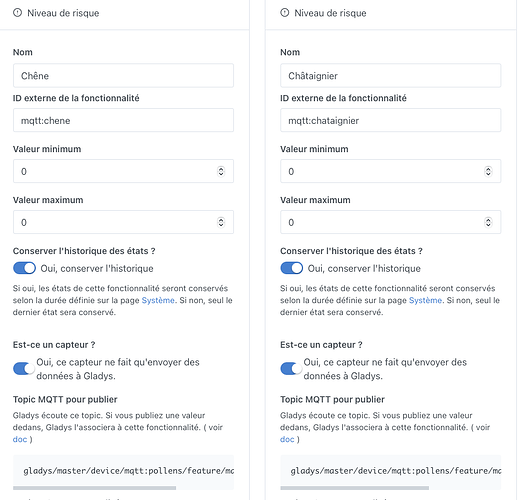

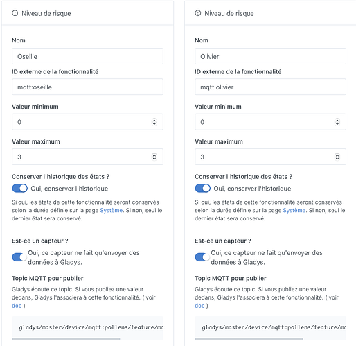

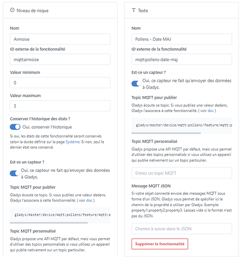

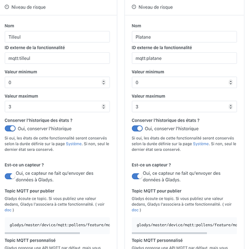

Here is the MQTT device with the features:
If you have any questions/comments, feel free to let me know :slight_smile:

Edit 13/05/2024:
  • Modification of feature types to risk level with the release of Gladys 4.41.0
Edit 15/05/2024:
  • Addition of the update date and time
What a Node-RED flow :joy:
See if there’s an existing feature similar to yours that has colored badges
Otherwise it can be added to Gladys, it’s pretty simple honestly.
Indeed it’s quite a flow :sweat_smile:
Thanks for your feedback.
I don’t think I’ve seen any existing feature that resembles this one :frowning:
Would you like me to create a feature request for that?

        "id": "bbc343252cb25eac",
        "type": "tab",
        "label": "Flux - Pollens",
        "disabled": false,
        "info": "",
        "env": []
        "id": "7ac575237abb4457",
        "type": "http request",
        "name": "API Request",
        "method": "GET",
        "ret": "obj",
        "paytoqs": "ignore",
        "url": "https://www.pollens.fr/risks/thea/counties/69",
        "tls": "",
        "persist": false,
        "proxy": "",
        "insecureHTTPParser": false,
        "authType": "",
        "senderr": false,
        "headers": [],
        "x": 350,
        "y": 340,
        "wires": [
                "bf36dd6349fe905f"
        "id": "bf36dd6349fe905f",
        "type": "function",
        "name": "Extract Data",
        "func": "const data = msg.payload;\\n\\n// Extract relevant information\\nconst pollenRisks = data?.risks;\\n\\n// Create separate messages for each pollenName\\nconst messages = pollenRisks.map(risk =\\u003e {\\n    let levelText = \\\"\\\";\\n    switch (risk) {\\n        case 0:\\n            levelText = \\\"Aucun\\\";\\n            break;\\n        case 1:\\n            levelText = \\\"Faible\\\";\\n            break;\\n        case 2:\\n            levelText = \\\"Moyen\\\";\\n            break;\\n        case 3:\\n            levelText = \\\"Elevée\\\";\\n            break;\\n        default:\\n            levelText = \\\"Inconnu\\\";\\n            break;\\n    }\\n    // To remove accents\\n    const removeAccents = str =\\u003e\\n        str.normalize('NFD').replace(/[\\\\u0300-\\\\u036f]/g, '');\\n\\n    let a = removeAccents(risk.pollenName);\\n    a = a.toLowerCase()// Comment out this line to keep the first character uppercase\\n    msg.topic = \\\"gladys/master/device/mqtt:pollens/feature/mqtt:\\\" + a + \\\"/text\\\";\\n    msg.payload = levelText ;\\n    node.send(msg);\\n    //return {\\n        //topic: `pollen/${risk.pollenName}`, // Topic is unique for each pollenName\\n        //topic: risk.pollenName, // Topic is unique for each pollenName\\n        //payload: levelText,\\n    //};\\n\\n// Output all messages\\n//for (const message of messages) {\\n//    node.send({ payload: message });\\n//}\\n",
        "outputs": 1,
        "timeout": "",
        "noerr": 0,
        "initialize": "",
        "finalize": "",
        "libs": [],
        "x": 530,
        "y": 340,
        "wires": [
                "5810137e3ac9c2a1",
                "8ee9057a695c554b"
