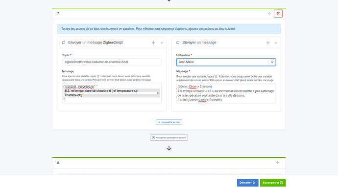

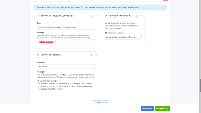

I sent the value 1 to the thermostat to indicate the state of the virtual button “Forced stop”, then I retrieved the setpoint temperature value for the bathroom.
The last action of the scene will also have
END of (Scene: scene name)
Once your error(s) are corrected, simply change the recipient of the Telegram message to “Pause Debugging” so you no longer receive messages. It is then no longer necessary to delete them, because they will help better understand your scene when you consult it later, like annotations. In case of a problem, it will be enough to send the messages back to your account.
Below is an example of a message sent by the scenes.
NOTE: I had not yet integrated the name of the scene that triggers the message into each message.
