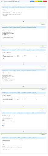

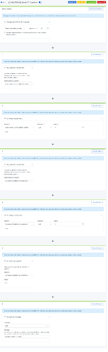

I have several identical scenes for managing my heating; see below 2 that turn the heating on (T° Eco or T° confort) and 2 that turn it off. The T° Eco or confort information comes from a fake device, which is itself managed by 2 scenes that change its state depending on days and times.

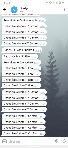

I’m asking for your help to understand why each time the scene runs I receive the end-of-scene message twice.

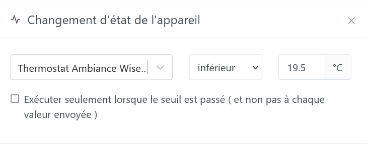

You can try checking the box to avoid running the scene each time the value is sent

Also, I didn’t tick the box on purpose because in some situations it didn’t trigger or stop the heating.

Here are:

Hello, I haven’t had time to deal with my issue, but since yesterday I’ve been receiving 4 messages :thinking:
However, I didn’t do anything special, just went to check the zigbee2mqtt page on port 8080.
