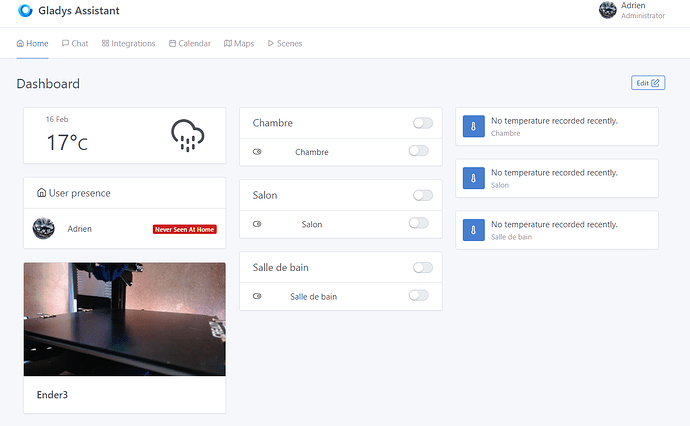

After several searches to connect my OctoPrint webcam with Gladys V4, I found nothing on the forum.
So I found a solution and I’m sharing it with you (if 3D makers who use Gladys are interested).
Maybe some people already knew the trick, but since I couldn’t find it, I’ll take the liberty of making this little tutorial.
In Gladys V4
Integration → Camera
In « RTSP/HTTP Camera Stream »
(retrieve the IP of OctoPrint, your Raspberry Pi)
and add « ?action=stream »
This will retrieve the OctoPrint stream to incorporate it into Gladys
http://your-octoprint-ip:8080/?action=stream
  • Perform a connection test
  • Save
And head to the dashboard
  • Add a Camera Widget
And enjoy!!
