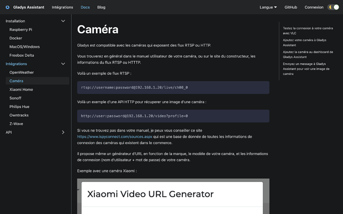

New tutorial: Add your RTSP/HTTP cameras to Gladys Assistant 4
Here’s a new tutorial in the documentation: Adding a Camera in Gladys Assistant 4 :slight_smile:
Available in the documentation here → Caméra | Gladys Assistant
I have added 2 RTSP-compatible cameras to the Integrations page, if you have other references, feel free to propose them in a PR :slight_smile:
