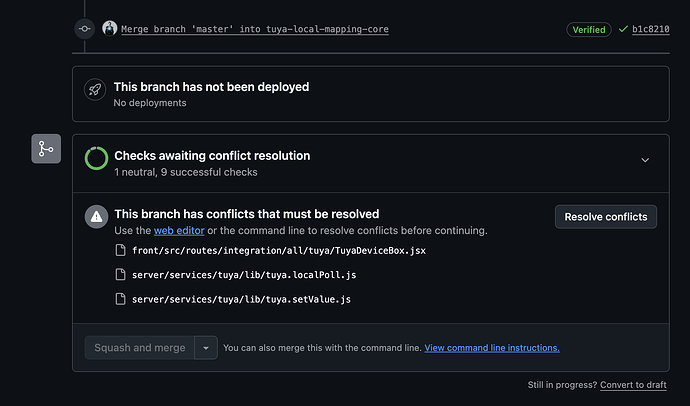

Hi @Terdious ,
I’d really like to merge the PR 3 , but there are conflicts:
As soon as you can run Claude on it to resolve them, let me know and I’ll merge it
