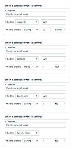

I propose a trigger in the scenes that could be configured as follows:
Features:
  • Ability to trigger a scene if any event from a calendar occurs in XX minutes/hours/days. Possibility to select one or more calendars. The calendar must be a shared calendar, as scenes are shared within an instance.
  • Ability to add a condition on the event title. Ex: is exactly « music lesson Â», contains « pool Â», contains « work Â», contains « school Â», starts with « Class Â», ends with « volley Â».
  • The trigger runs in advance relative to the start or end date of the event: 10 minutes before, 1 hour before, 1 day before. The finest granularity is the minute. It is possible to set 0 minutes to be notified at the start/end time of the event.

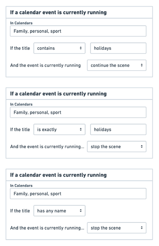

Functional specification for the condition in the scenes
For the conditional part in the scenes, the idea is to be able to continue or interrupt a scene if an event in one/more given calendar meets a condition and is ongoing.
Example:
  • If a movement is detected
  • There is an event in the calendar that is ongoing that says I am at work
  • Then send me a message
Proposal:

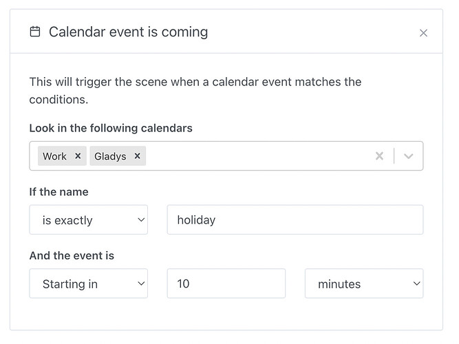

The complete view with all options:

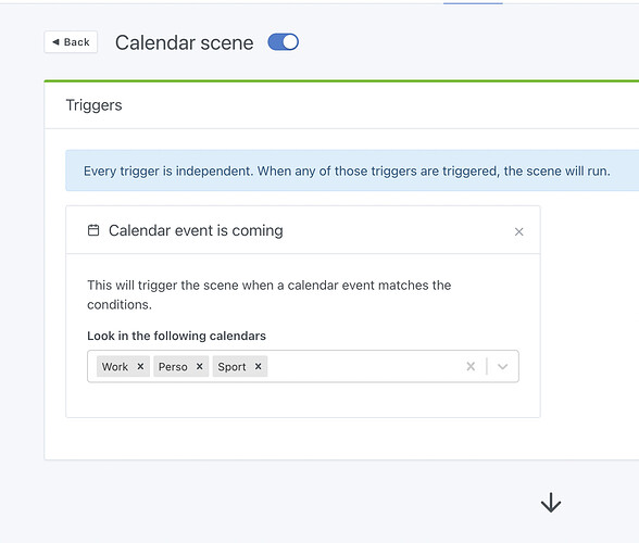

What is powerful is that it is possible to retrieve in the actions the event that triggered the scene! :sunglasses: and this gives:
