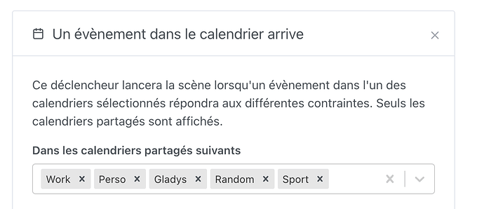

Indeed, only calendars « shared Â» within the Gladys instance are displayed.
Private calendars are excluded from scenes for privacy reasons.
I added a message in the UI to make it clearer:

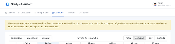

Also, on the calendars page, I added a message for new arrivals who don’t have calendars configured:
Now it’s clearer!

I removed the possibility of having these fields empty. By default, they are filled in, and only modifiable for another value.

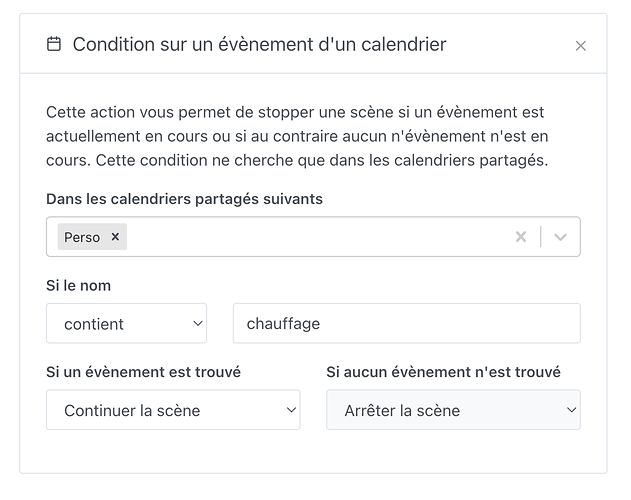

I just merged part 2 of this development: condition on ongoing events in scenes.
The principle is to be able to continue or stop a scene only if an event is found / not found.
I made a build on the Docker dev tag which contains this condition:
gladysassistant/gladys:dev
I’m open to any feedback :slight_smile:
Once all this is tested, I will deploy a new version of Gladys!
Hello everyone! I’m open to feedback on this second development before I release it :slight_smile:

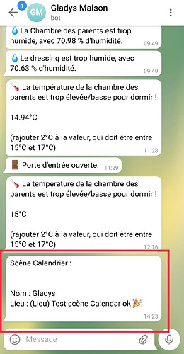

Here is my test in a scene:
  • Scheduled trigger (to simulate a specific detection)
  • Continue only if an event is found in my calendar, with any name
  • Send a message
I wanted to send a message with the details of the event (name, location, etc.) but it’s not possible because there are no variables, unlike when I use the calendar as the scene trigger event.
And no way to call « get the last state Â» necessarily.
:play_button: If it’s possible, it would seem more logical to create these variables by default in the scene when « continue only if Â» with the calendar is called. As the trigger part does.
Oh indeed, I didn’t code the variables for this trigger, I thought it wasn’t useful in this case
 After all, you’re right, it can be useful.
I’ll do it today :slight_smile:

It’s good for the variables, the PR:
Not yet merged, no dev build yet.
I’ll keep you posted when it’s live in dev!
The dev build has passed, available at:
Feedback is welcome!

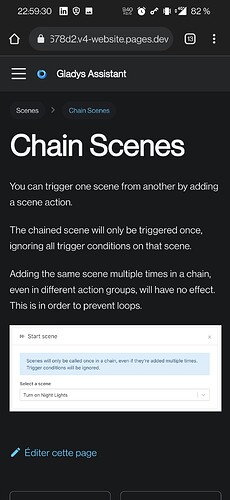

While out for a stroll, I found it clear and easy to understand!
However, I found some English on the French page:
Great!
Yes, that’s « normal Â», this page has never been translated (feature developed by an American who doesn’t speak French).
I would be happy to receive a PR on this topic if someone wants to help, there has been a GitHub issue since November: In the french documentation of the "ScĂšnes", a part is in english : “Chain Scenes” · Issue #102 · GladysAssistant/v4-website · GitHub.
