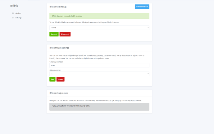

The module is functional but I’m still reviewing the UI, I need testers to finish the module
I changed the device creation mode for switches, it looks like this:
The setup tab now displays the last received command:
