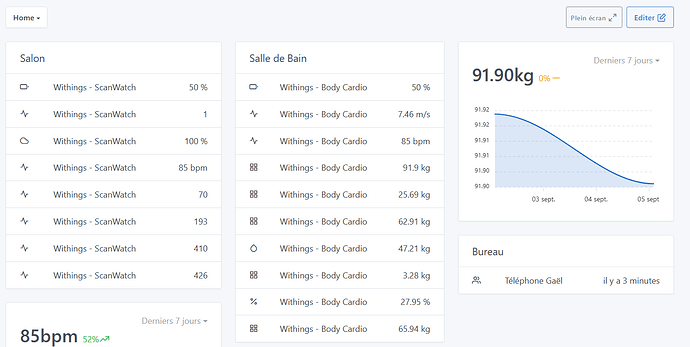

Sorry for not replying sooner, Docker runs on a VM on my Freebox so yes, and
thank you for your feedback,
this display only indicates the execution of the data aggregation tasks for the charts; it has no connection with fetching the latest data (the display of « NaN ans » is a bug that has nothing to do with this integration and was fixed in the latest versions but the image I made is older than that fix).
can you check the logs to see if there is an error related to Withings?
and it seems to me that the charts that show the last 24h use the raw data and not aggregated data, do you also have this problem if you look at just the last 24h?
For your information @euguuu there is a bug in the function device.saveHistoricalState.js, the aggregation calculation doesn’t work because the value set in the device_feature is not correct.
I noticed the bug in the Enedis integration tests because I also use this function.
I am in the process of fixing this bug

Yes, I have the same problem in the last 24 hours, the heart rate graph on my watch isn’t displaying anything.

Hello @euguuu,
Sorry for not getting back sooner, I still have the same sync issue; on April 6 I disconnected and reconnected the integration, the data updated correctly but nothing since.
