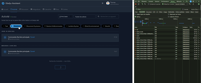

  • Server: getDeviceStatesHistory accepts a since bound → one query = a bounded time window, which returns what it contains (even less than 80) and never expands. A bounded window responds in milliseconds thanks to DuckDB zone maps. Without since, behavior strictly unchanged (backward-compatible).

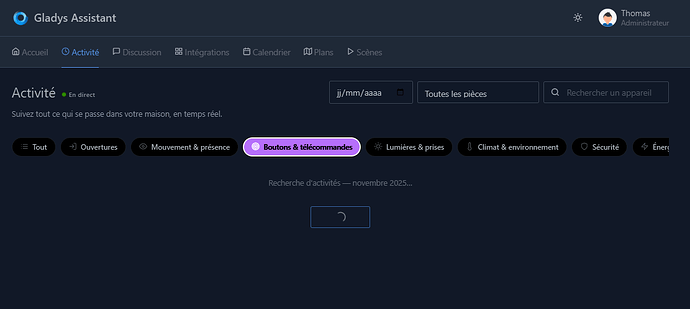

  • Frontend: The Activity view probes 1 → 2 → 4 → 8 → 16 → 32 months then a final unlimited query, displays each batch as it arrives, with a banner « Searching for activities — March 2025… » while older windows are probed in the background.

« Openings » filter (few states, old) 20 to 33 s of frozen spinner First states in ~100 ms, the page completes in the background
« Buttons » filter (states at 17 months) 22 to 51 s Immediate banner indicating the scanned month, states as they are found
