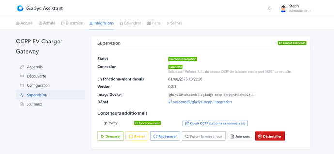

I’m testing the HA solution to see if the issue I’m identifying is specific to my device or the library, and here’s what I found: +1: +1: +1:
The system is taking shape
But I need to review the operation and configuration management.
I’ll work on this over the weekend :wink:

So either I’m missing information, the main container can perfectly open ports and make them available on the network, and in that case, I agree with you, tell me how to do it and I’ll modify it without any issues. Or it’s not possible and therefore it’s not overkill :wink:
You’re right, I spoke nonsense :smiley:
I double-checked the spec: the main container of an external integration intentionally has no published ports, its only incoming channel is the outgoing WebSocket to Gladys. Published ports only exist on the sub-containers declared in containers[]. So for OCPP, where it’s the charging station that connects as a WS client, the companion container is indeed the only option today. Not overkill at all :smiley:
After that, nothing forces you to use a third-party image in the sub-container, containers[].docker_image also accepts yours. You can therefore declare a sub-container that runs your own OCPP server if you ever want to limit external dependencies!
That’s exactly what I implemented: GitHub - sescandell/gladys-ocpp-integration: Gladys OCPP EV Charger External integration. · GitHub
