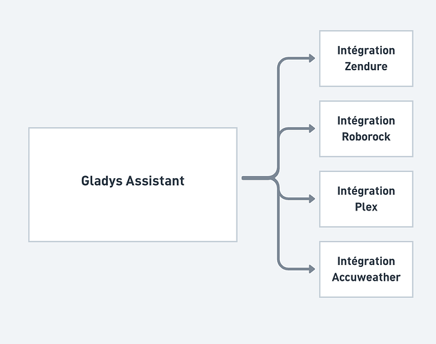

Proposed Architecture
A Docker container per integration
Gladys already runs exclusively in Docker, with the Docker socket mounted. We rely on this: each external integration runs in its own container, created and supervised by the Gladys core.
This container is locked to the maximum:
  • no privileged mode, no access to the Docker socket
  • no access to the database or Gladys files
  • read-only file system, except for a small data directory that is its own
  • strict limits on memory, CPU, and number of processes
  • network restricted to the hosts that the integration has declared in its manifest.
An integration that crashes, leaks memory, or goes into an infinite loop remains confined in its box. And a malicious or poorly written integration cannot « go modify the database live »: the SQLite file simply does not exist in its file system.
This choice brings an important bonus: integrations are no longer limited to Node.js. A Docker image can contain Python, Go, Rust. Each author embeds their dependencies in their image, and all the build is done upstream, at the time of publication, never at runtime at the user’s end.
In the long term, this choice also brings something interesting: it will be possible to run remote integrations!
All communication goes through the host API
An integration never touches Gladys’ internals. Its only entry point is a host API: the integration communicates with the core via a simple HTTP JSON REST API, in the same spirit as what already exists in Gladys today.

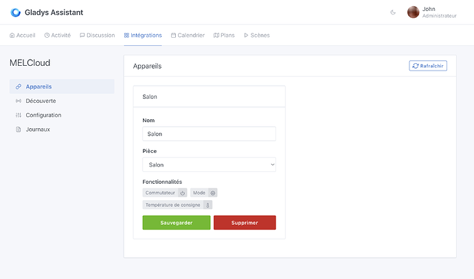

Interface: declarative, no arbitrary code
This is probably the most debatable choice of this RFC, so it’s best to clearly assume it.
Integrations do not provide interface components. They describe their needs, and it’s Gladys that renders the interface with its own design system:
  • the configuration is described by a schema (type JSON Schema): Gladys generates the form, the validation, the error messages, in an identical way for all integrations;
  • devices are declared in the existing device/feature model: they are automatically displayed with the same cards and the same controls as native integrations;
  • for more specific needs, a vocabulary of declarative widgets will be defined and progressively enriched, according to the real needs reported by developers.
What it costs: a developer won’t be able to create a fully custom screen. What it guarantees: a consistent interface everywhere, no XSS vulnerabilities from a plugin, no front-end version conflicts, and an identical experience for the user regardless of the integration’s origin. Given the project’s priorities, I think this is the right compromise. But this is exactly the kind of point on which I look forward to your feedback.

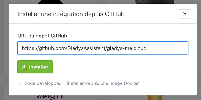

3 new repositories created:
Implementation in progress by 3 Fable 5 agents:
I’m getting ahead because Fable 5 is not guaranteed to stay after July 19th.
If you have any feedback, of course everything is still modifiable, I’m really open to feedback!

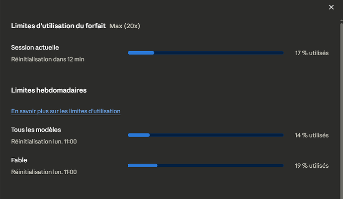

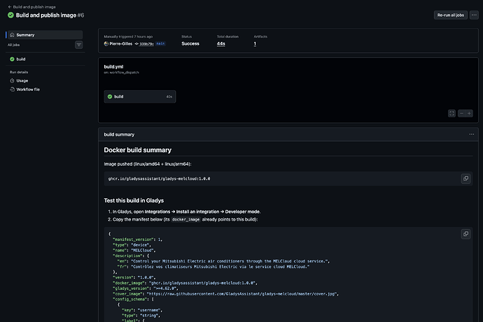

Quick update: Fable 5 did great work yesterday and generated PRs on all relevant repositories, almost exactly following the specification I wrote on Monday. :rocket:
On my side, I will move on to the review and testing phase by the end of the week.
It’s quite impressive, as this is a project that, just a few years ago, would probably have required several months of development. If everything goes as planned, we should be able to release something very quickly.
I’ll keep you posted on the next steps! :slightly_smiling_face:

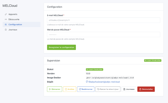

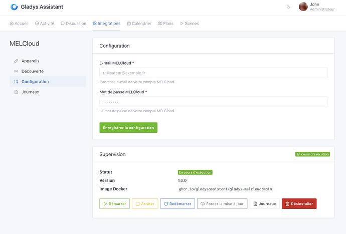

The idea is really to completely decouple the integrations from the core and have a clear and stable API surface between the two.
For now, the specification and implementation only cover the devices part. I haven’t yet addressed the weather, communications, or other domains, but they will naturally be added following the same model.

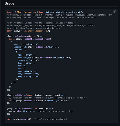

To give you an idea, an integration will look like this:
Source: GitHub - GladysAssistant/integration-sdk-js: Gladys Assistant SDK for JS external integration · GitHub
However, if an integration requires a new core capability (for example, a new device type), it will indeed be necessary to:

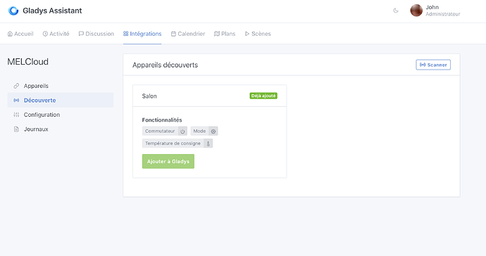

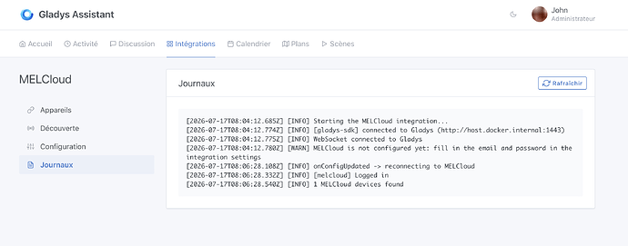

I’ve converted the native Melcloud integration into an external integration (GitHub - GladysAssistant/gladys-melcloud: Gladys Assistant external integration for Mitsubishi AC · GitHub), of course one-shotted by Fable 5.

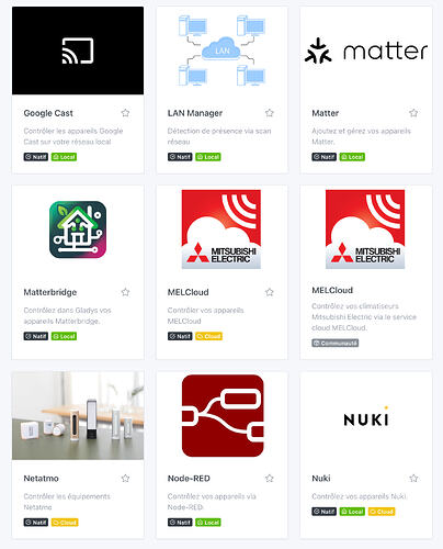

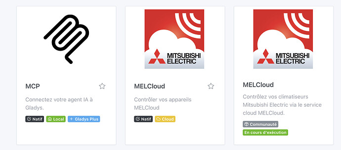

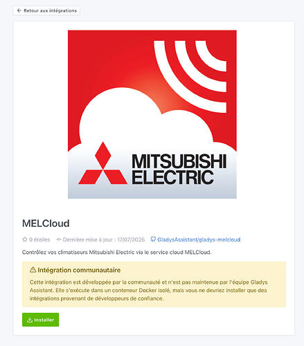

Example of a display of a « community » integration vs « native » :
The integration list also includes both native and community integrations, coming from the store.

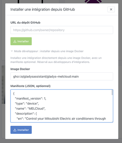

It’s also possible to launch an integration from Github :
Or from a Docker image for testing :
Then, not many differences with a classic integration :
In short, it really works well!!

The external integration template you can give to Claude as a source: GitHub - GladysAssistant/integration-template-js: Gladys Assistant Integration template for a JS external integration · GitHub
The JS SDK: GitHub - GladysAssistant/integration-sdk-js: Gladys Assistant SDK for JS external integration · GitHub
To test in Gladys, you can launch Gladys locally on your machine on this branch: External integrations (RFC phase 1): Docker supervisor, host API, integration WebSocket, decentralized store and generic frontend by Pierre-Gilles · Pull Request #2665 · GladysAssistant/Gladys · GitHub

I switched to Max+ for pro dev this week, and they reset my credits yesterday… I guess as a gift ^^ so I have some leeway until Monday :
Incredible, enjoy it while Fable 5 is out :smiley:

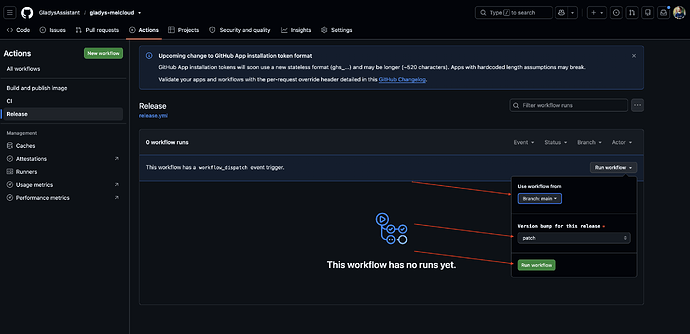

Then, to test an integration, you have 2 options, and nothing to configure, everything is already ready in the template, it’s turnkey :slight_smile:
Option 1: Test via GitHub
You create a release in one click, and it automatically generates a Git tag + a push of the image to the GitHub Container Registry. Super simple :
Then, in Gladys, you paste the repo link :

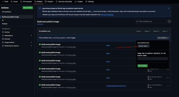

Option 2: Test via Docker image
More practical for testing a PR before publishing it in production for all users of the integration.
You start by choosing the branch to build :
This will then publish a Docker image tagged with the branch name.
In the release, you will find all the information to copy into Gladys :
To copy into the interface :
