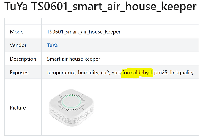

First, you must be sure that the category/the type exists in Gladys.
It’s recommended to start from your device page Tuya TS0601_smart_air_house_keeper control via MQTT | Zigbee2MQTT, then look at the details of the « expose » for your feature (we don’t handle options):
Here, you can see that your feature is of type « numeric », that the name of its attribute is formaldehyd, and you even have its unit µg/m³.
