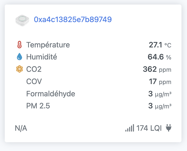

Now, in Gladys I don’t have PM2.5 or formaldehyde for now :
What would be the steps to properly add that to the Zigbee2mqtt integration?
