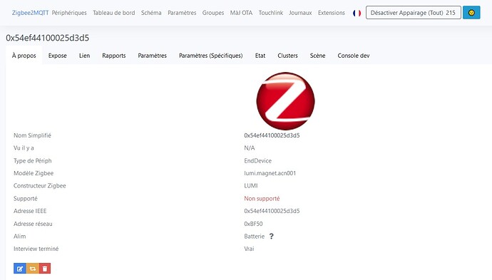

The door opening modules are still not being detected
You need to pair them

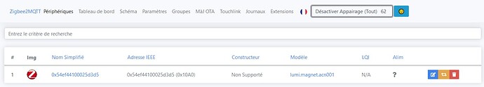

Yes, I go to Zigbee Discovery, I allow the association, I put the module in pairing standby by holding down the button until the LED flashes, I start the scan
 and nothing appears.
The scan in Gladys is to correctly list the Zigbee2MQTT devices paired and configured in Zigbee2MQTT.
If you don’t see them in Gladys, it means the pairing is not finished or it didn’t happen.
The Zigbee2MQTT management interface is normally available on port 8080

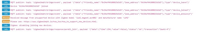

Normally you don’t need to check all this
It’s just that it will help us understand what’s happening on the Zigbee side because Gladys has no control over this part.
Unsupported device, see
I also found this:
You’ll need to be patient, the latest Aqara sensors (2021) are being supported (they have some issues)
