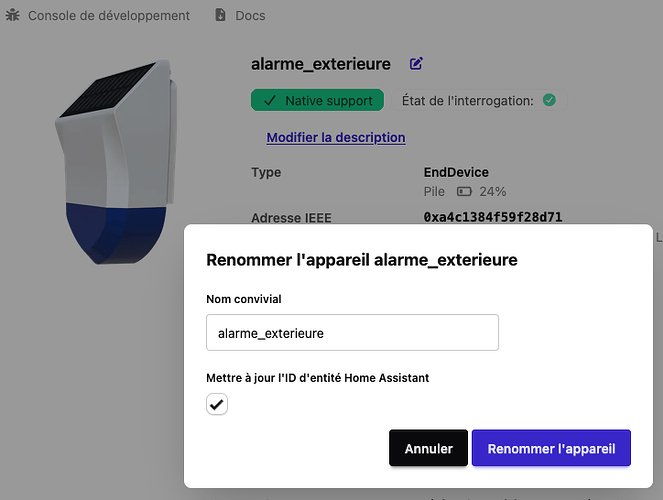

For information, in HA, it is possible to propagate renaming from the Z2M interface by checking this option.
But I find option 2 more stable and less prone to human error.
