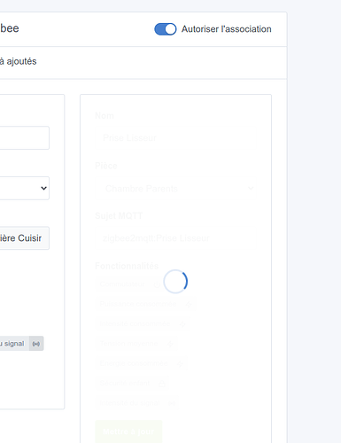

I just clicked ‹ Update › on my Prise Lisseur device.
I’m left with a loading icon … and absolutely nothing new in the Gladys logs.

Then went back down now… yet my spinner is still spinning on my dashboard:
I should also note that my Gladys is unusable… nothing else loads in the interface :confused:

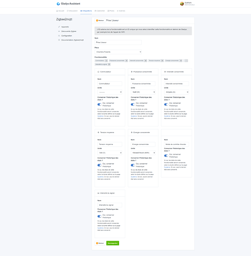

By any chance did you change the data retention settings on these devices :

However, it’s possible that I changed those retention settings, but that was about two weeks ago (I had posted about my full hard drive issue), so I did a bit of cleanup in there.
If I understand correctly, I made the change, so the device was added

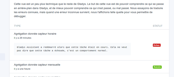

You can check in the « Background Task » tab if there have been any cleanup tasks, they appear in that tab :slight_smile:

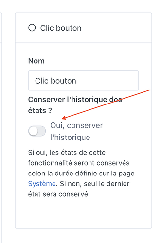

I hadn’t checked just before, but I’m almost certain that I had unchecked several settings 15 days ago
Not sure that helps :
Ok, that confirms my doubts!

No, that’s not that kind of job.
