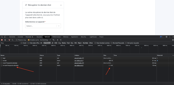

Do I have a scene with 9 devices, is that a lot for G+?
Can you check the local response size of this API call (GET /api/v1/device)?
9 devices can contain a lot of features/a lot of parameters
(In the browser => Inspector => Network)

No SSH, just in the browser:

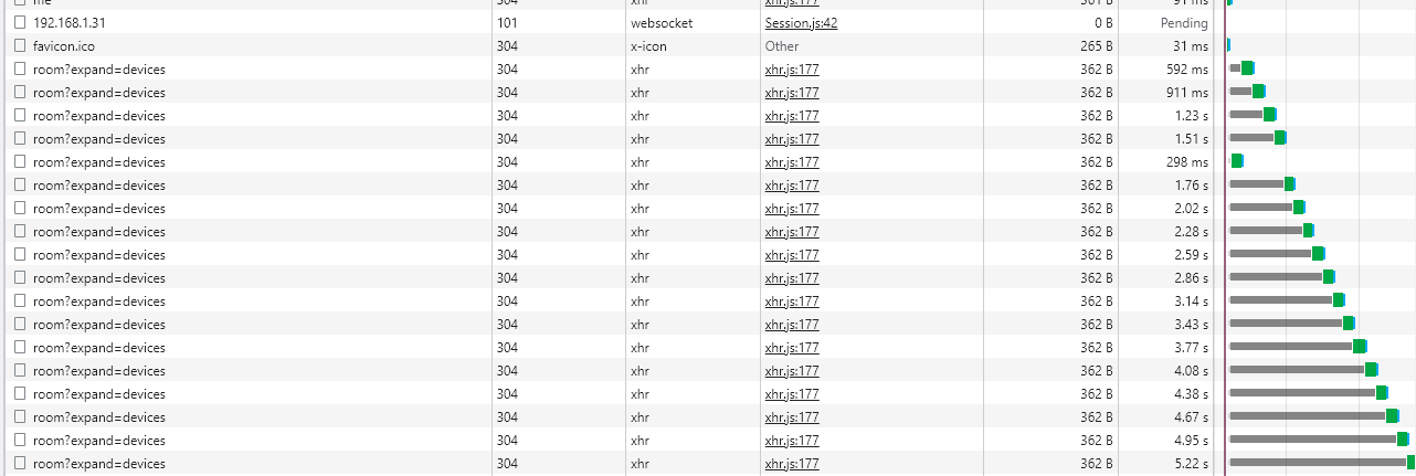

I tried to reproduce the issue, but I couldn’t
I wonder if it’s not a concurrency problem, that is, all requests are sent at the same time and your Pi struggles to respond and trips over itself..
Because locally, the browser has a natural concurrency of a maximum of 5 requests in parallel per domain (Browsers generally have a concurrency of 5 HTTP requests per domain), whereas on the Gladys Plus side, there is no concurrency on websocket calls, and therefore this could saturate your Pi (it’s a lead)

@Tlse-vins I made a special Gladys Plus deployment to test if it’s a concurrency issue!
Could you connect to Gladys Plus at this URL and check if you still have the bug on your problematic scene or not: https://622f6796b80f670ca367960c--distracted-almeida-5007a2.netlify.app/login?return_url=%2Fdashboard
