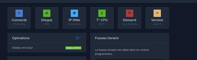

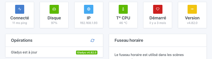

Another point, I find some redundancy between the yellow version of Gladys and the green version:

The label, I think, would be more accurate if we put ‹ Host IP › instead of just ‹ IP ›…
What do you think?
On the contrary.
At first I had put IP address but it was too long. I can try with your suggestion and take a screenshot for you.
For the version yes it’s redundant I agree

@GBoulvin, here you go
