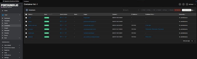

The installation is easy and reproducible. I currently have a mini-PC with Gladys and other services that I find necessary. I tested my Zigbee SMLIGHT dongle and it is correctly detected by the OS and Gladys.
I deployed a Docker with Avahi to have a local address ‹ gladysbox.local › which is much more convenient than looking for the IP on the internet router.
I have Portainer for managing the Docker containers.
