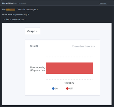

Hey @pierre-gilles ,
I have applied and checked the remarks except:
Could you tell me more about this part:
I tried to reproduce it but, despite zooming in/out, changing resolution, etc., I never managed to get your result. However, before my previous change I had the same issue, but I fixed it before your review. So I still reduced it to only 10 characters max just in case… ^^

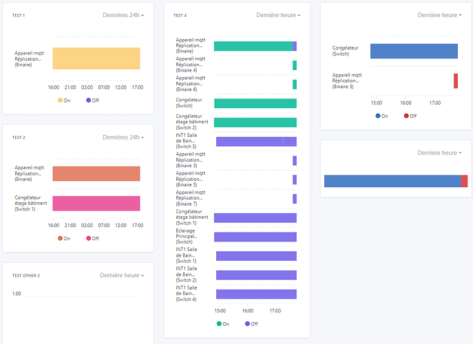

Here’s what it looks like on my end:

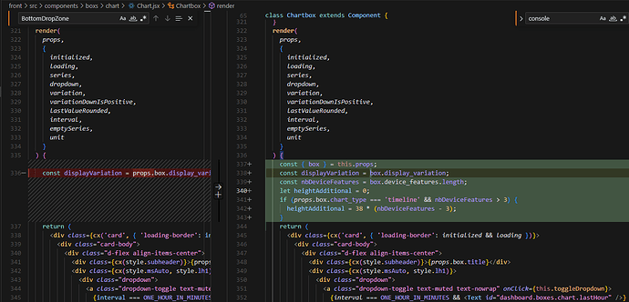

I would have liked to be able to rename my feature (like in Room Device) because right now it’s way too long ^^
Otherwise it’s all good on my side!!
Thanks for the test Guim31 !!
In the end, it doesn’t surprise me.
I must be missing something once again. It would be crazy if we couldn’t better adjust the axis titles. I’ve spent hours on the docs and on StackOverflow… there’s no way « I » can find a way that’s not hacky…
@Terdious I don’t know if you’ve played with the yaxis options?
Typically you can specify a minWidth
That will take up space on the chart though, no secret — this kind of chart would benefit a lot from the ability to have 2 or 1 columns ^^
Otherwise, you need to give the user the ability to rename the device like for the « Devices » widget
pierre-gilles:
After that, well it’ll eat into the chart, so no secret — this kind of chart will benefit a lot from the ability to have 2 or 1 columns ^^
Yes, and that was exactly it, it reduced the chart so much that I gave up. But indeed a mix of that and renaming can handle the abusive cases.
And as you say, no secret, choosing the number of columns is very beneficial (tested on a merge of the two PRs. But even at 2 columns it was still very average …
So I’ll go with that then? ‹ minWidth › + ability to rename (the edit box is going to be huge )
[quote=« Terdious, post:78, topic:6599 »]
So shall I go with that
I’ve found a first compromise I think is interesting with ‹ minWidth › and a few changes. I fully loaded one of the boxes to really test.
I’ve just pushed, @pierre-gilles does Cloudflare restart automatically or is that a manual action on your part?
I’m continuing with the renaming option now, so if that’s an action on your part, it
