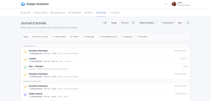

I asked Cursor for the best of both worlds:
Each line can be grouped if there are multiple states from the same sensor in a row.

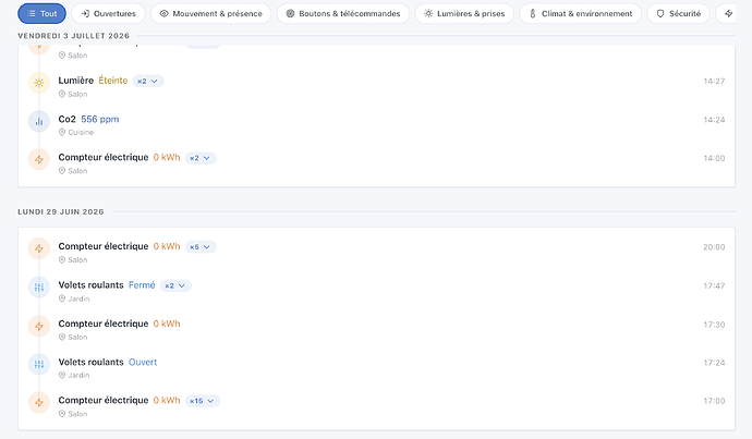

The post-patch version of Fable 5:

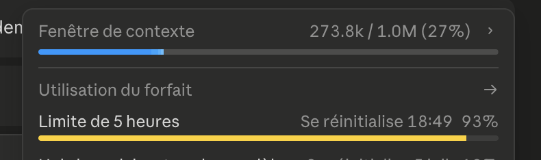

Good thing, though I blew my afternoon Claude quota with all this
I also prefer the Fable 5 design, but it’s really just a small difference.
However, I see that it only handles one date field. And it’s true that Cursor’s proposal for dates was better.
Lol, yeah, it stings ^^ And impossible to share it …
It’s true that when testing the Fable 5 design in real life, I ultimately find it more comfortable to use.
So it’s actually quite interesting, when you select a date, you « jump » to the date but you can see the days around it, so it’s super practical!

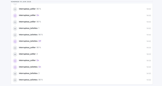

Does the top-of-page filter remain sticky at the top, though?
The date remains sticky but not the filters:
Oh yes ^^ No, on my end, I was more referring to the page header with the filters + dates + search:
Because when you search in a history log, you like to be able to filter quickly ^^

@Terdious the header is now sticky, but only the device type selection.
I tested it and it’s really clean!
Sticky — yes, I think it’s a good idea, but not for the entire header: date + room + search sticky would take up ~140px of height on mobile, almost a fifth of the screen. What I did:
the filter bullets by category remain stuck at the top when scrolling (a single compact, horizontally scrollable line, with an opaque background) — it’s the tool we use the most while browsing the feed;
the day headers stick just below , so while scrolling we always see « which day » + « which filters »;
search and date remain at the top of the page — we access them with a quick scroll, and the « Return to Live » button / the « N new events » badge remain floating anyway.
