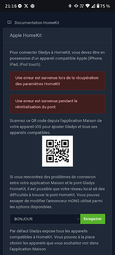

Apple HomeKit not working since the last update 4.86.1
Since version 4.86, my iPad no longer communicates with Gladys.
I tried deleting the bridge, restarting, resetting, but nothing works. Messages appearing in Gladys:
Log:

On my end, I didn’t have any errors, but I noticed that by default « BONJOUR Â» was selected and adding it to HomeKit with « BONJOUR Â» didn’t work
By using « AVAHI Â» everything is fine

That said, there is still an error when I click on ‹ restart â€ş
2026-08-15T21:43:58+0200 <warn> errorMiddleware.js:83 (errorMiddleware) Error: Cannot add a Service with the same UUID '00000049-0000-1000-8000-0026BB765291' as another Service in this Accessory without also defining a unique 'subtype' property.
