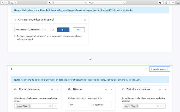

In fact, I want to place a sensor in a cellar, associated with a smart bulb, which turns on and stays on as long as the person is inside.
I don’t know if this information will help.
What’s not working? I have that setup with the same sensor and it works very well :slight_smile:
It should work. Could you send us a screenshot of your scene?
I’m probably messing up the scene configuration…
Yes the last one with the 3 actions can’t work.
Everything you put in the same block is executed at the same time.
So you turn it on, you turn it off and you wait.
You need to modify and add 2 other blocks below.
So one block to turn on
One block to wait
And one block to turn off
And will the scene restart as long as someone is in front of the detector?
