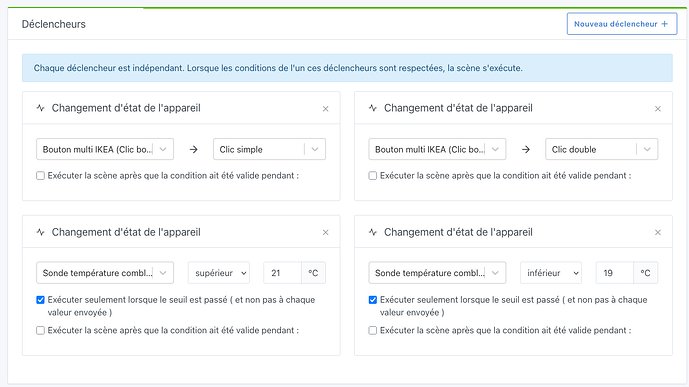

Triggers for the different actions
I see 4 (we’ll adjust the different actions later):
  • Heating in Comfort mode → single click of a button
  • If the temperature exceeds 21° → auto-trigger if temp > 21°C
  • If the temperature drops below 19° → auto-trigger if temp < 19°C
  • Heating in Frost Protection mode → double click of a button

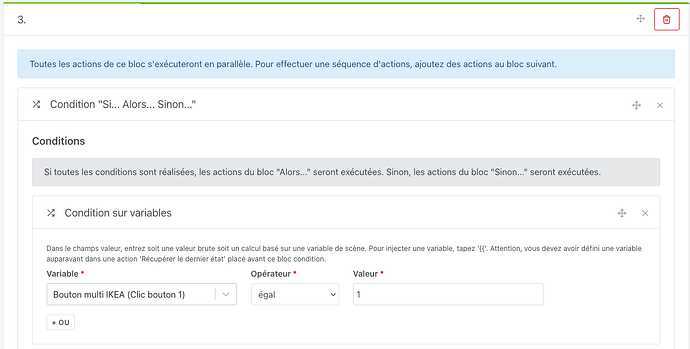

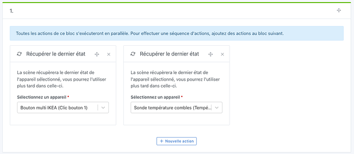

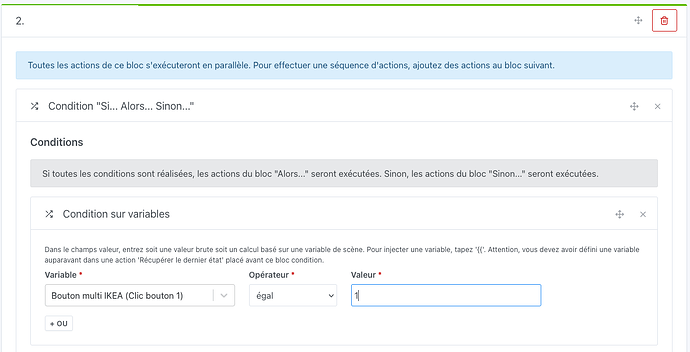

Global Action
In my example below, don’t pay attention to the names (I didn’t replace them with « cellar »).

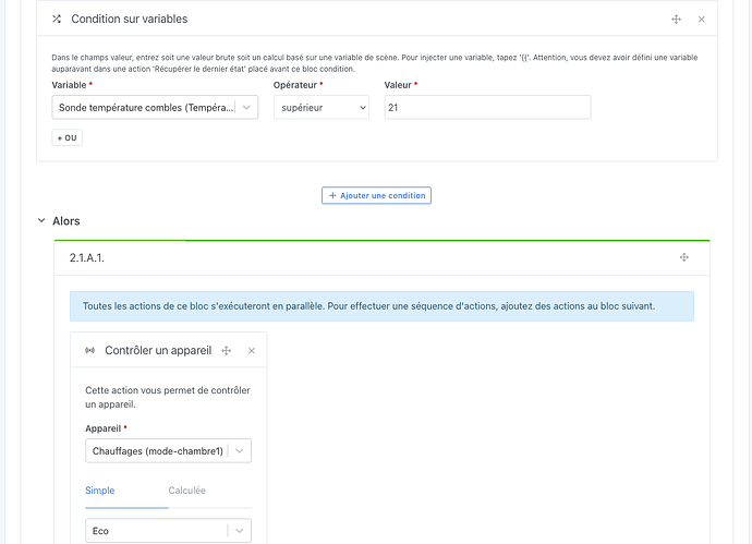

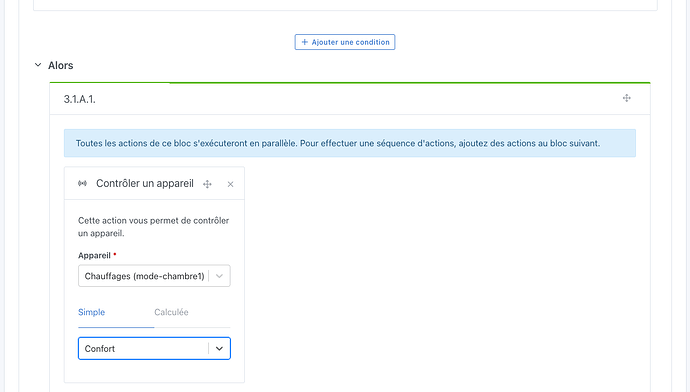

Comfort Action & temp > 21°C
For the heating mode values, I’m basing them on the Gladys code because we don’t have the direct « human » correspondence:
Comfort Action & temp < 19°C
On this block, you’ll need to be careful because we’re asking to switch to Comfort mode. Outside of this scene, it monitors the change in heating mode and triggers when we switch to Comfort mode, so we’ll inevitably re-trigger Comfort mode in a loop until the temp is >= 19°C. There may be safeguards to add as well.

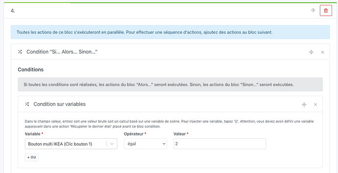

Frost Protection Action

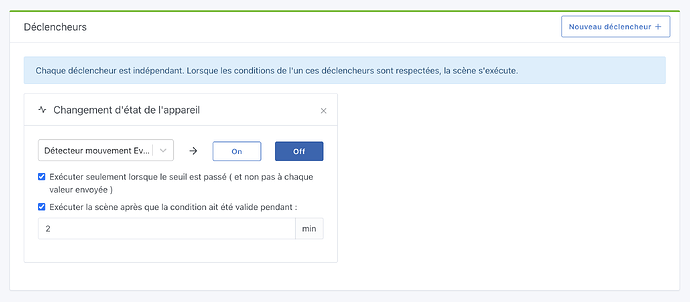

To add an explanation about the inactivity period, you can use this very practical function:
The « Execute the scene after the condition has been valid for » checkbox allows you to wait for a specific time before triggering your inactivity action.
