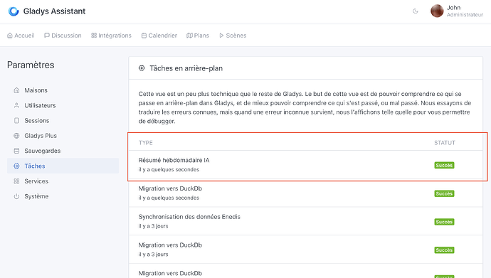

To make troubleshooting easier, I’m adding the generation of weekly reports in Settings → Tasks. This way, we can track its execution and directly display the error if something goes wrong. ![]()
I also took the opportunity to add a random delay to the start of this task. Instead of all Gladys instances sending their request exactly at 18:00:00, each will now wait between 0 and 60 seconds before starting. This will distribute the load and avoid a spike in requests on the Gladys Plus servers.
All of this will be available in the next version of Gladys
