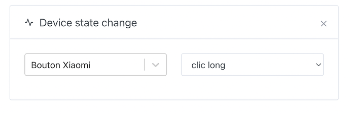

What I’ve always said is that these values should never be shown to the user, that’s not the philosophy of this v4!
Instead of having to write manually 1, 2, 3 or 4, the user should just see a selector in the scenes, something like this:
(not coded, just a mockup)
That way no one has to remember these constants which are just internal implementation details :slight_smile:

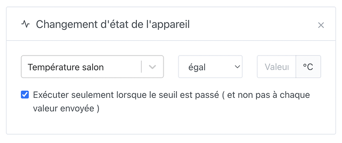

It’s just display, yes! Nothing new though, we already do it for quite a few types:
Binaire:
Appareil de présence:
Capteur avec unité:
The idea is that we never display values that come from our internal workings in the UI; we always show a nice component, translated, and clear to use.
