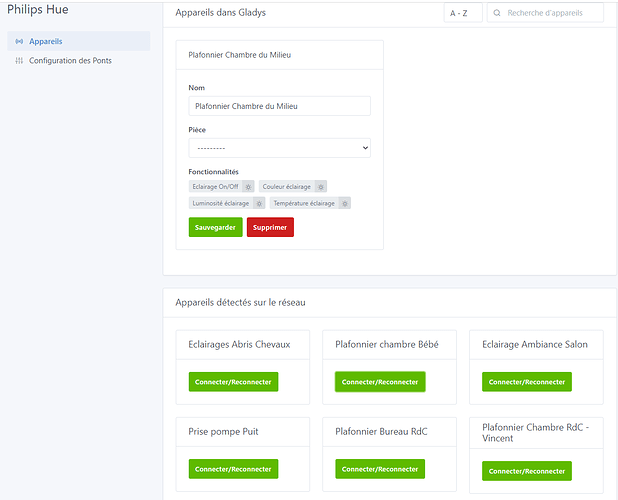

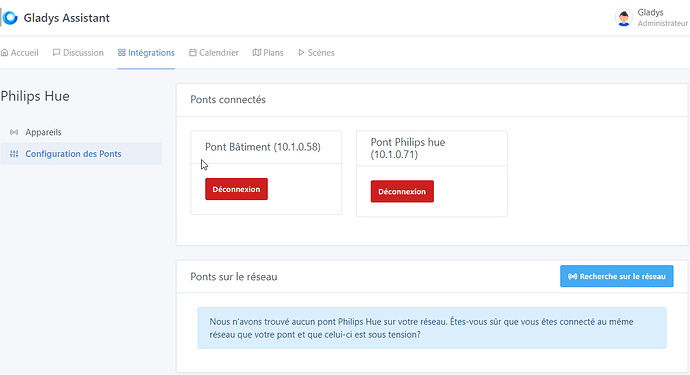

Edit : For info (I don’t know if it’s important), my Pi is on the LAN 10.5.0.x, the Broadlink is on 10.1.0.x, on my Pro and Netatmo images which are on the same Pi, the Philips Hue Bridges were previously found (a long time ago), but I see that no longer:
but they are still functional:
But on the Broadlink image they are not visible (new DB). Could there be a link? Yet I’ve always used the same command to start the images.
Parentheses
I haven’t tried the Broadlink service yet, but as for me, I haven’t been able to find the Hue bridge for a while either. Since 4.8.0 or 4.8.1.

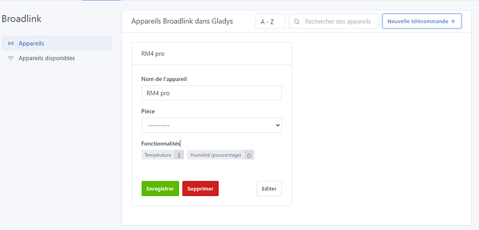

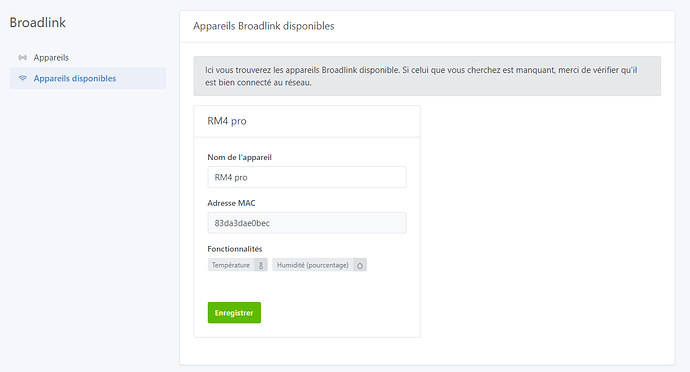

After adding the device, the button correctly switches to « Already created » but after refresh it asks to register it again even though it appears correctly on the devices page:
The « Save » button works fine when changing room.
The edit button causes the page to freeze (requires refresh) and the following front-end error:
