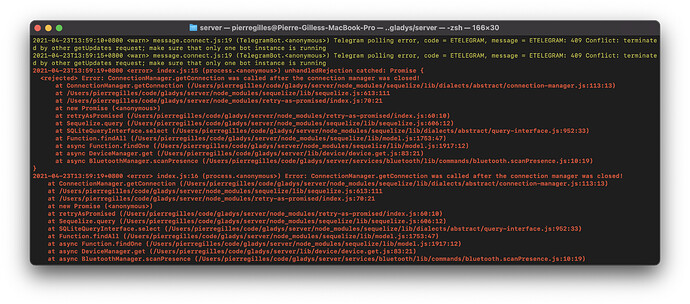

I’ve had a bug recently when developing locally. When I start the server with nodemon, it seems that when the server hot-reloads, the old server is still running:
This causes Sequelize to display strange bugs, Telegram can no longer connect because it is already connected, and the websockets are broken.

I see this issue when I kill the process, error logs from multiple services, and it doesn’t always terminate, I have to manually go kill the process.
I get the feeling that the db is shutting down before the services are cut off, the call to the stop method then fails.
