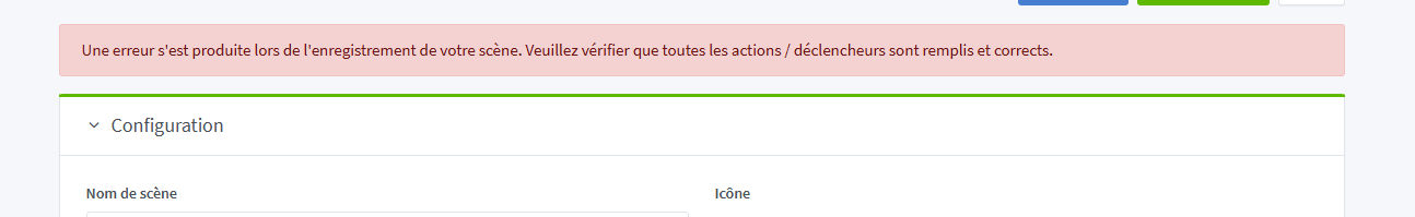

So the error feedback is as follows
to reproduce this error you just need to create a presence detection scene
then duplicate the scene
go to change the device state and save
If you delete the trigger and don’t recreate it, there are no issues
Good luck finding where this comes from

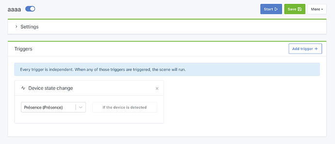

  • I created a scene « aaa »:
  • I saved it

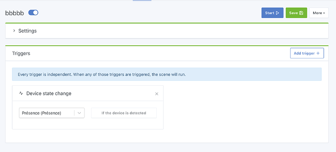

  • I duplicated it into a scene « bbb », I saved:
  • I saved
Everything works ^^
