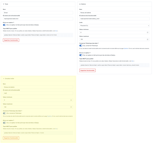

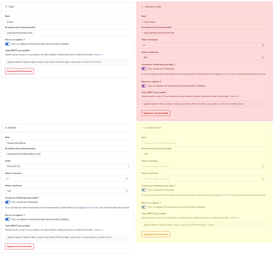

if I create a feature and leave it empty, no problem:
If I delete another feature, the one that was empty changes:
It takes the information from the last filled block.

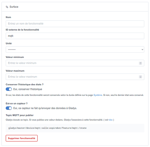

I also tested with blocks of different types.

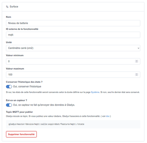

If I create several new blocks, only the 1st one ends up with data; if I delete this new 1st block, the next one inherits its data.
So data is being taken from the block that existed before it.
Like block No.10 (living room temperature)
Block No.11: new empty block
Deleting block 10
Block 11 becomes 10 and retrieves the old info from block 10.
