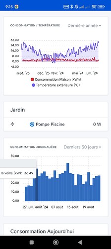

Today I noticed that on mobile the popup for a histogram chart overflows to the left of the screen:
Hi @guim31 :slight_smile: It seems to me there was already a GitHub issue, but I can’t find it anymore.
I think it’s a bug in the library we use for charts; see whether updating it fixes the problem or not, otherwise we’ll need to check if an issue already exists in their repo.
Can you take care of this little investigation?
We use ApexChart in Gladys
PS: I found the issue and reopened it ( On Chart, when hovering a "Bar" chart, the tooltip can be outside of the window · Issue #1762 · GladysAssistant/Gladys · GitHub ). Could you check on the Apexchart side if this is a known bug?
