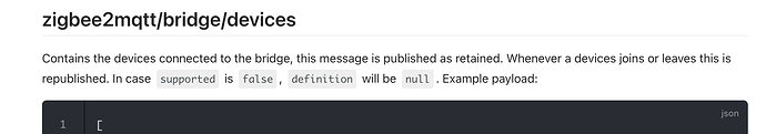

So here’s the question: under what condition does the Zigbee2mqtt container send the device information?
The documentation mentions:
Which would therefore explain why we get nothing in this variable!
But then, I find it hard to understand how it can work at other times?

@AlexTrovato Do you know when this topic is called by Zigbee2mqtt, and what assumption was made during development for it to work? ^^
In the Zigbee2mqtt code, here are all the conditions for Zigbee2mqtt to re-publish the list of devices:
(We are in the Bridge.start function):
@pierre-gilles because the message on the topic zigbee2mqtt/bridge/devices is « retained », as soon as the MQTT client connects to that topic on the broker, this message will be received, since it is « sitting » in the broker.
So normally, on Gladys startup, as soon as the service is initialized, Gladys receives the full state of the connected z2m devices, and should therefore populate this variable.
Well spotted, that’s the detail I was missing, I didn’t even know that existed in MQTT! Thanks.
But that makes it clearer why it doesn’t work if the MQTT broker has been restarted — I don’t think we have persistence on Mosquitto, so if the broker is reinstalled by Watchtower, then Gladys is restarted, and Zigbee2mqtt is not restarted, Gladys is « in the dark »
