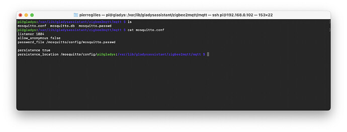

Directory /var/lib/gladysassistant/zigbee2mqtt/mqtt:
Restarting Mosquitto no longer seems to bother Gladys! ![]()
